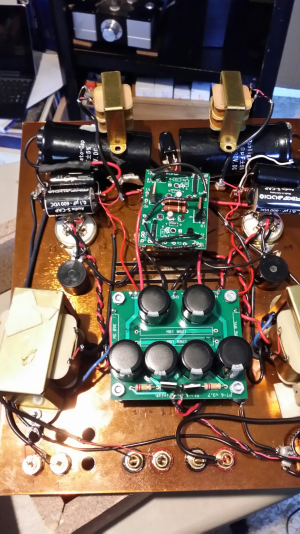

This 2A3 Stereomour had some hiss in my horns.  To correct it I ordered a variety of 431's to try to get it lower.  After 3 try's I went with 665 ohm cathode resistors (I think that's the correct term for the resistor from 3 and 8 to ground on the 12AT7).  Still had hiss but after a dozen or so tube swaps I accept it, it is what it is.
Somewhere along the way I broke something, turning on the amp today after work gave a couple of loud tics and a loud squeal that got louder and louder till I shut down the amp.  Swapped power tubes, same result.  Swapped 12AT7's same result.
I'm assuming it's oscillation. It's new to me, I've had motorboating, this sounds different.  Anyone have a "readers digest" version of what oscillation is/does to the amp?
Going to re-wet all the new connections I've made since the last working version of the amp and hope that fixes the problem.  If not then will try the chopstick search for bad connections.  The amp worked well before the resistor changes but I'll check everything.

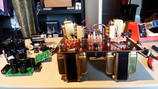

The last working configuration was as a 2A3 amp with 12at7 input with C4S (still using the 431).  No selector switch and 100K resistors instead of a pot.  M4 grid chokes instead of the 249K grid resistor.  Ten turn 50 ohm hum pots, 15uF caps across pots.  Dowdy plate chokes instead or the PC-3, BH-5 output instead of the OT-2, 30uF parafeed cap (.3uF bypass) instead of the 3.3uF original cap.  In the power supply used the PC-3 at 270 ohms instead of the parallel 1200&360 resistors, Cree diodes instead of the UF4007.  Ran this way with 2A3-40 or 2A3 meshplates, different 12AT7's for a month or so.
Changes I made leading up to the squealing;
4 replacements of LM431's.  Each with a startup, play around 4 minutes (nickel hum disperses) then check for hiss.
Added 2uF PS bypass caps from HV+ to ground, checked for hiss.
Cut black wire from B3 and B8 at Kreg, added 665 ohm resistor from wire to ground, wire doubled on itself and twisted twice.  Started up, a little static pop and crackle, no changes to hiss, played a couple of hours.
Came in the next day, on startup, couple of pops/crackle and the squeal starts.  Fuse is good, swapped power and input tubes with no changes.
So that's where I'm at today.  Thanks in advance for any/all help in diagnosing and repairs, but especially for explanations, its another opportunity to learn about amps.
