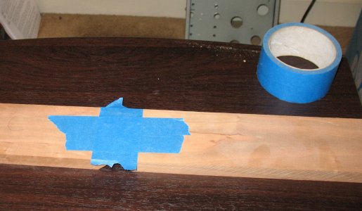

What I recommend is use the Bottlehead approved taping of the chassis pieces together so they fold up into square after applying glue to the miter faces but entirely tape the face area adjacent which protects them from the glue. The bit of glue that might squeeze under the tape is more easily dealt with.

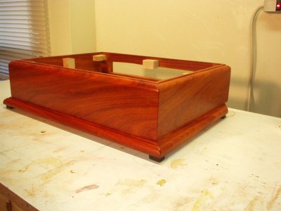

Best practice though is to wipe shellac on the chassis pieces before glue-up and after sanding them with 220 grit paper, being careful not to get shellac on the miter faces. The shellac resists the glue perfectly and seals in any resins or minerals in the wood that show up only after finishing.
Especially if you use band clamps, shellac is mandatory. It also looks great under varnish like Sherwin-Williams Classics Fast Dry Oil Varnish (friends don't let friends use Urethane). Or you can continue wiping on multiple coats of shellac to create a beautiful finish.
Pix show band clamp in action and a 12 coat Amber Shellac finish on Padauk.

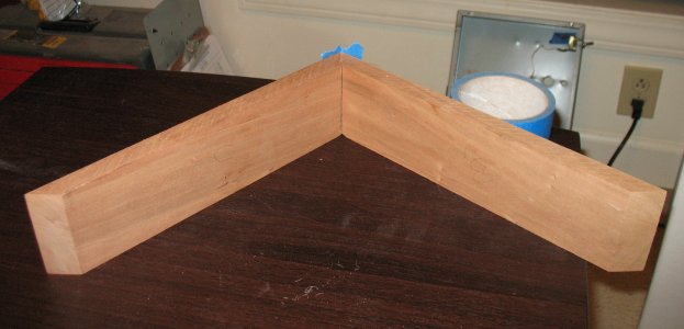

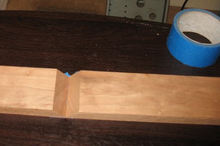

If you want to be like Mike but not make a career out of it, Stretch masking tape over the pieces  completely covering an inch or so each side of the joints. You want to put tension on the tape to make a tight joint. Flip the 4 pieces over to expose the faces of the miters and spread WHITE Elmers or Titebond on them. Thinly cover both faces of each joint (you're gluing quarter grain which is quite porous, a subject for another time), square them up, apply the last bit of tape and next day you have a chassis ready to finish.
