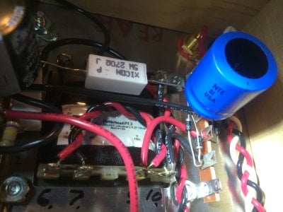

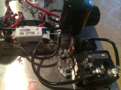

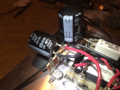

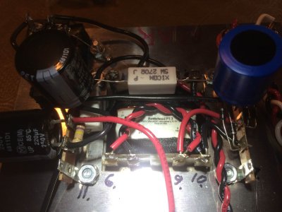

Then you should start by posting pictures of your power supply.  We will want to check the orientation of the diodes and capacitors.  Also the transformer wires should be visible.

But before that, make sure you are using the correct fuse. What is the rating of the fuse & is it fast-blow or slow-blow? (Should be 1A slow-blow.) And what is your mains voltage?
To quote from PB:
Blowing fuses generally means that something is in backwards, or two things are touching which shouldn't be.  Your diodes and capacitors are correctly oriented, but you should carefully inspect the power supply built on the two 6 lug terminal strips.  Look for adjacent terminals that have untrimmed component leads that might be touching.
And yes, photos help!

I'm using 500mA fuses.  Blew the one that came with the kit and replaced at the local electronics store.  Pics as requested by Grainger.

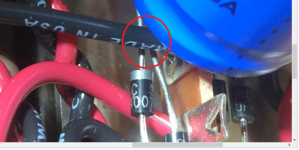

If these two bare diode leads touch, you'll blow fuses all day.

I still have the short.  The diode leads do not touch so that's not it.  I changed the cap (yes same voltage and micro farad designation).   This was one of my mistakes but has been corrected AFTER I overheated and (possibly) fused the cap.
