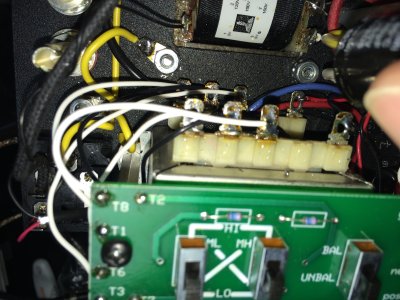

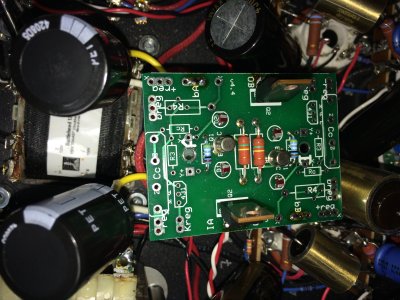

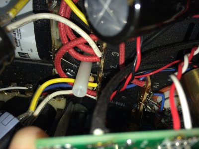

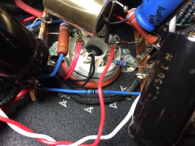

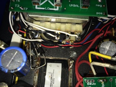

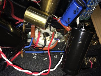

sorry to hear your issues. the sex should be dead quiet (mine is), so there should be a solution. can you post pictures of the underside? the guys here in the forum often spot something that could potentially help solve the problem. also please describe the noise that your hear. Is it low fequency 60 or 120 Hz like or high pitch? Also post the voltage readings as per check out process.
Good luck and don't despair!

@Mc
The noise changes if I switch back n forth between high and low on the impedance switches. Anything specific I should take photos or should I just post a bunch at different angles. There's a lot to photograph under the hood
