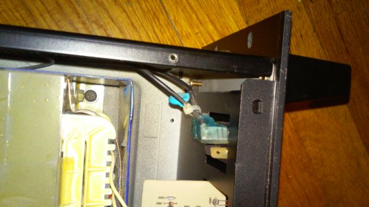

Reply #11 on: June 11, 2015, 04:01:47 PM
Got 3 of 4 screws in.  There is a screw deep in one side in the pic below, can't seem to get that one in, even with a right angle screw driver.  Any suggestions?
Dave
Reply #12 on: June 11, 2015, 11:50:28 PM
Does the bottom of the chassis come off?  Would it help to remove the two slide on lugs on the power switch.  If not, you might need to unmount the power transformer.
How did your friend remove the handles?
Offline aragorn723
    • Posts: 1050
Reply #13 on: June 12, 2015, 12:12:34 AM
It was quite a few years ago, but he didn't take anything apart.  Maybe it was just a regular straight-shafted screwdriver, but I can't remember.  It looks like there are some screws on the bottom that hold in the faceplate, so maybe if those come off and there is enough slack in the cables going to the front board, I can work it that way.
Dave
    • Posts: 20286
Reply #14 on: June 12, 2015, 01:13:00 PM
Go to the hardware store and get a hex head screw to replace that one, then use a ratcheting box end wrench to snug it in.
