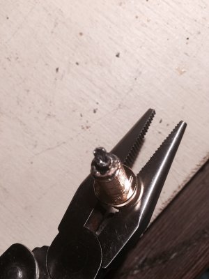

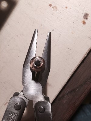

Hello,
First-time builder here. Almost done with resistance verification. While my Right RCA Jack center line reads ~90K ohms, my Left RCA Jack center line reads 0 ohms. Ground lug for both RCA jacks measures 0 ohms. All other resistances are correct. What do you think I should do? Get a new jack from RadioShack or something, and then resolder? Here's a photo of the jack. I've tried using a desoldering pump, but what you see is about as good as I can get.
« Last Edit: June 11, 2015, 12:07:27 PM by LuckyGus »
Online Paul Birkeland
    • Posts: 20304
Reply #1 on: June 09, 2015, 07:44:23 PM
Yeah, that's hosed.  You might be able to scrape out more solder with a metal pick, give it a try.
You can also purchase a new jack from [email protected].  Be sure to include your name, that you ordered a Crack, and a photo of your jacks (we switched somewhat recently to a different jack, but still have some of the old ones).
Offline LuckyGus
    • Posts: 7
Reply #2 on: June 10, 2015, 04:12:24 AM
In the meantime, would it still be safe for me to start performing voltage checks?
    • Posts: 20304
Reply #3 on: June 10, 2015, 05:50:28 AM
I wouldn't really recommend doing that.
