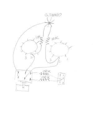

Can you draw what you have?   If you had a 10K resistor across input and ground on each pot, and a 100K resistor between the input and the pot, that would pad down the input properly.
Offline Bill Epstein
    • Posts: 104
Reply #4 on: June 13, 2015, 10:29:28 AM
PIC:

Reply #5 on: June 13, 2015, 01:57:29 PM
150k should have read 100k.
Something must be right because it sounds great.

    • Posts: 20300
Reply #6 on: June 13, 2015, 08:54:05 PM
What are the two toggle switches for?
The signal needs to go into either 3 or 1, whichever isn't grounded.  The signal comes out of 2 and goes to the preamp.

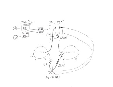

Reply #7 on: June 14, 2015, 02:06:20 AM
Sorry, I can't even Paint-By-Number
    • Posts: 104
 It came to me in a dream that the Attenuator was 50k and George's circuit wasn't going to be happy no matter what padding I tried.
I swapped the 100ks in series with the VC input for 47 k and removed the 10k to ground.
That's it! 12 o'clock is serious listening loud, the tone is as good as the Attenuator unpowered and the better dynamics and weight are there in spades.

    • Posts: 20300
Reply #9 on: June 15, 2015, 07:02:50 AM
Ah, what I thought was a toggle switch is actually the pot.
The 100K resistors are where you want them.  The 10K resistors go from "In" on the pots to ground.

Reply #10 on: June 15, 2015, 07:45:23 AM
Thanks Paul. Don't know how I confused "out" with "in" in your reply to my padding query under Legacy but there it is.
I did good work back when I was drugged, now that I'm medicated...not so much.
