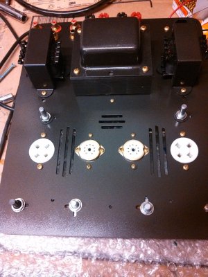

    • Posts: 634
Reply #4 on: June 29, 2015, 06:27:26 AM
If you look in my "a little help please" post Paul pointed out that the resistance on #45 can't be 0 Ohms.
For me it was easier to attach the heat sinks to the little board prior to wiring it in and attaching it to the standoffs. YMMV.
I still have a couple of Voltages to iron out, but I gotta say it looks pretty cool with all 4 bottles lined up on deck.
This is a preview picture from a few days ago.
