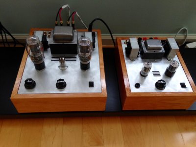

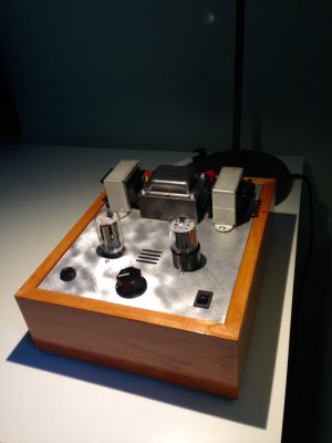

Pics!    Enjoy, the S.E.X. really is a great bit of kit..
Offline crooner12
    • Posts: 27
    • My YouTube Channel
Here are some pics. I think my Stereomour needs a 2nd coat of miniwax...
Mark
Current projects: Stereomour
Nice, i never realised how much bigger the stereomour was.  I would love to hear your impressions of the two, assuming you have tried your speakers on both?
