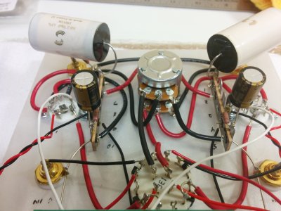

Hi,
My Quickie 1.1 has the stock Nichicon 150µF 16V capacitor.  I have 3 pairs of other capacitors and I'm wondering if it's worth replacing the stock caps with any of the below:
-- Elna Cerafine 100uF 25V
-- Nichicon Muse KZ 100uF 25V
-- Black Gate 47uF 100V
I'm leaning toward the Cerafine. I'm also happy keeping the stock caps if there's not much benefit in making the change. Thoughts?
Boulos

The Muse are in!  When I want to change them, I will cut the leads flush with the cap (sacrificing the cap), make a little loop at the tip, and solder whichever other caps to the loops.  After that, changing caps will be easy.
