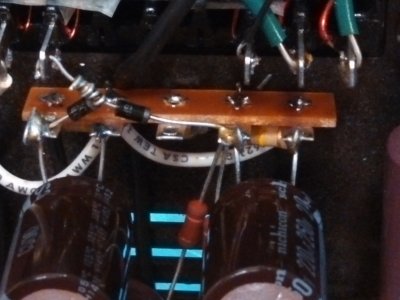

I thought I'd start a new topic to attract attention. I finished the build and ran the resistance checks and all was well until #45.
It should be 0 Ohms, but it reads like the other side, varying readings up into the mega ohms.
I re-flowed both 45L and 45U
Bad cap?
Thanks for any help on this.

Karl. I have the first version but if that is a resistor across the electrolytic it looks broken

Thanks for looking, it is a bad phone picture, just to show proper location and orientation. 45U is on the right end of the strip, striped side of the electrolytic, nothing else attaches to 45U. All the other electrolytic caps read 0 in the striped side.
Still puzzled

It appears to me that T45 and T42 might read high or low depending on which meter terminal is grounded.

Paul, thanks for the reply. I tried 2 meters, both terminal alignments but 45U always acts like the unstriped side of any of the electrolytic caps. Still stumped.

45 and 42 are connected, and will not measure 0 Ohms.  This is an error in the manual.
