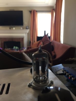

Can you see two glowing dots on the top of the 12UA7?
Offline OldManNiko
    • Posts: 7
Reply #2 on: July 03, 2015, 08:08:10 AM

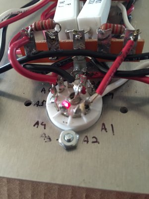

Both tubes are lighting properly.  Here's some pics of the tubes lit as well as the LEDs on the A tube base.
Offline Strikkflypilot
    • Posts: 459
  • Shellac fiddler
Reply #3 on: July 03, 2015, 08:33:07 AM
It is not possible to verify the polarity of the LEDs from You pictures but the A8 led looks situated very close to a blob of solder on the center pin. Scorched?

Yep it's a scorched LED.  I unsoldered it, and was not able to get it to light independently.  I doubt the local Fry's will have a replacement, so I'll await a new LED from the fine folks at Bottlehead.  Does this explain the voltage irregularities elsewhere in the circuit? I have no idea.  But I know I cannot proceed any further without the LED as it seems to provide much more than some light, bias voltage if I am correct.

AFAIK these LEDs are there to make sure 1.5vDC is drawn for bias voltage for each side of the 12AU7(cathode biased). If You have a working LED, I believe it is ok to short A3 to A8. Correct me if I am wrong, Paul.
Thanks for the help.  Jumpering did the trick.  Now to warm it all up.  No noise at all that I can hear.  I'll do another voltage check tomorrow to make sure heating the unit hasn't cause some value changes.  Again thanks for the help in getting this going!
