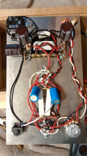

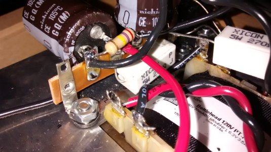

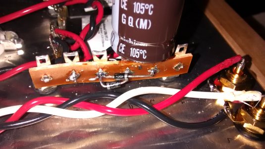

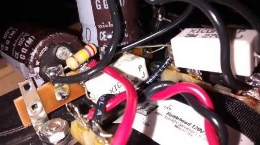

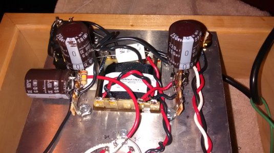

I actually resoldered the capacitors 4 times over. In fact the soldering gun hit the coating of the capacitors and I replaced them. But anytime I tried resoldering I wouldn't get any changes. It could be that each of my soldering jobs aren't good enough so I included a bunch of pictures to get your judgment. I made sure to touch the incoming capacitor leads/other wires instead of just the solder itself and made sure the solder was shiny when finished.
T14 was very crowded and each time I resoldered I hit a wire or capacitor (you'll see some burn marks on wires). So I diverted all the incoming wires on T14 and soldered them to one wire entering T14. It doesn't look pretty but has continuity and hasn't made things worse.
Any thoughts if the transformer could be the source?
    • Posts: 20302
Reply #5 on: July 06, 2015, 04:08:12 PM
Soldering guns are way too large for this type of work, even a $5 40 Watt iron will work way better.  I'd get the proper tool, then deal with those ground wires in the back (redo them so there's an actual ground buss), then also move the white wire leaving terminal 10 to route as it is in the manual, then have a listen and let us know what you hear.
