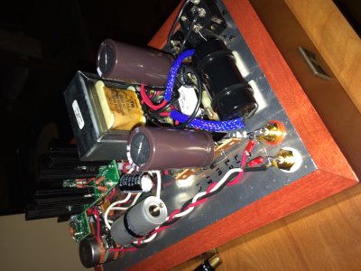

Like this(nathan post)? And 1 more question, is it possible to add(change) pair capasitor with the 75ohm resistor(red), read from some diy review, as coupling? I blind of this(include soldering) before built crack ;)

Reply #9 on: July 17, 2015, 03:08:58 PM
Yup- that's my picture but since taking the photo I moved the 75k ohm resistors from being soldered to the RCA's to being folder to the volume pot
Looking at the pot the resistors go to the upper left tab and the lower left tab
