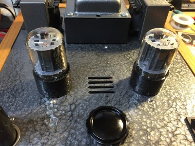

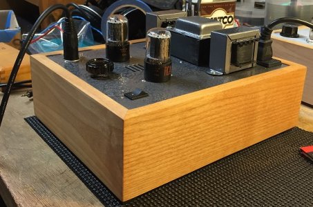

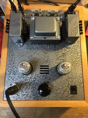

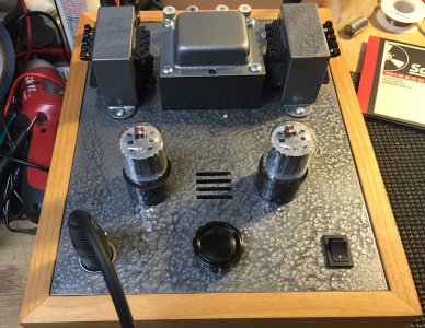

here's the pics
Reply #3 on: July 13, 2015, 09:04:58 AM
Nicely done, love the subtle mods 8)
Offline sbelyo
    • Posts: 117
Reply #4 on: July 13, 2015, 04:06:16 PM
Thanks...
I changed the headphone jack to a 4 pin xlr
The paint is a pewter hammertone finish form rustoleum. (Doc is right, this takes weeks to cure fully)
The volume knob in a NOS bakelite knob with the insert re-sized to accept the shaft of a goldpoint attenuator
The 4-40 hardware was replaced with stainless steel button head hardware
The RCA inputs and speaker binding posts are vintage audionote silver that I'd been saving for years
What you don't see is a goldpoint attenuator, CMC bakelite sockets, Mundorf supreme caps, a switch kit, and C4S

Can I ask a question on the XLR socket do you have it connected to the speaker posts.
 I wondered if it was possible for the Sex to still switch/disconnect automatically  from the speakers when you plug in with a XLR head phone jack as per the stock build?
 If the XLR is configurable like this I would be tempted to do the same mod with my Sex.
Cheers
Jamie
Offline sbelyo
    • Posts: 117
Reply #6 on: July 14, 2015, 05:18:45 AM
I do have it connected to the speaker binding posts.  Unfortunately there's no way to automatically switch it.  I knew this ahead of time but figured that if I intend to use it for speakers I wouldn't use it for headphones.  Really it's because I hate going back into a project once it's done.
I did see someone use a 4P2T switch to do it.
