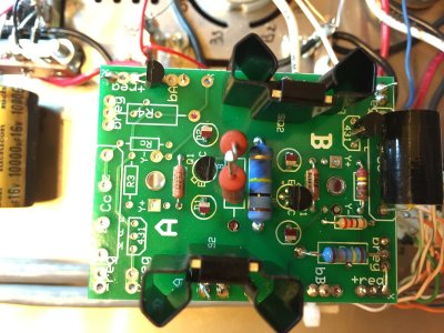

Hi
Just finished my smashup boards and installed them in my Smash preamp
The LEDs on the board on the A side won't light up, those on the C side light up OK.
So did the voltage check and here's what I got
Terminal.                A side.                               C side
IA                           210.                                    209
OA.                          0.                                       148
+reg A side.             2.48.                                   2.48
IB.                           0.                                     148.5
OB.                          -5.                                     61
K reg B side.             2.97 and fluctuating up.        4.40
B reg B side.             0.                                     148.6
+reg B side.              0.                                     148.6
B1       0
B2.      0
B3.      3.1 and fluctuating upwards
B4       0
B5.      148.5
B6.        4.32
I re examined all the components on the faulty board didn't find anything wrong
I re did the soldering by wetting all the joints to no avail.
So guys I'm in need of your help once more.
Good day to all

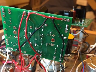

Can you post some photos of your build?  I may be able to spot a jumper that's out of place.
Trying to upload a couple of pics, hopefully

Can you confirm that the 431 regulators are in the proper holes?
Offline antoineestephan
    • Posts: 35
Reply #9 on: August 14, 2015, 08:09:03 AM
I checked them with a magnifying glass and they seem OK. Nothing seems off.
