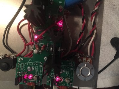

Okay It's definitely a soldering issue, I just realized that not all of the LEDs were on, does anyone know which joints specifically from the picture? It's going to be interesting re soldering this

Are those LED's on the big board glowing with no 6080 plugged in?
In all honesty, I would resolder every joint in the amplifier before going much further.  Keep at it until your T3 is back at 0V.

T3 is at 0, i really couldn't get an accurate reading on it, but i finally moved some stuff for soldering again. Then i plugged it in with the main tube to check voltages. While waiting the 30 seconds before doing anything, i noticed that some of the LEDs were off. If you can't tell by the build I'm a first time builder so i expected some problems. Is the only fix to this resoldering everything? I only had to resolver 2 joints on the original crack build.

OK, with just the 12AU7 in, what voltages do you get at 1-5?  Also, with just the 12AU7 in, if any LED's glow on the big PC board, there is a rather large construction mistake causing this.  Common issues would be:
Mixing up 2N2222 and 2N2907 transistors
Mixing up 31.6 and 237 Ohm resistors.
Mixing up jumper wires connecting to the PC board.
Backwards LED's.
Offline kt3z

And the LEDs?

Are the LED's on the socket glowing?  If so, I would be suspicious that you've switched the R1 resistors between the two boards.
