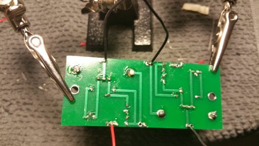

I am about to reapply the speedball mod and collect voltage information. I retouched all my solder points on my speedball boards. I've taken snapshots of the boards prior to installation here: imgur.com/a/m5feZ -- I'll update again in an hour or so once I've got my iron fired up and it reinstalled and voltages measured.

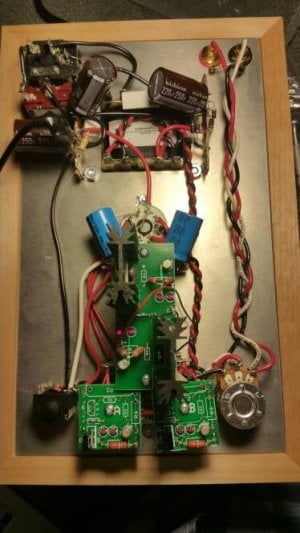

Alright, got it reinstalled with all fresh solder joints and I'm still only getting signal from the right channel.
1: 89
2: 225
3: 0
4: 225
5: 94
6: 0
7: 133
8: 0
9: 202 (should be 100... this might be important)
10: 0
11: 0
12: 0 (My ground pin)
13: 222
14: 0
15: 237
20: 0
21: 250
I've attached a photo of the circuit. All the leds are lit on the boards, etc.
    • Posts: 20281
Reply #5 on: August 06, 2015, 09:33:39 AM
Just out of curiosity, what do you see at terminal 9 with the 6080 not plugged in?
I can't ever recall an issue where the voltage at 7 or 9 went to full B+ after the installation of the Speedball.
I can tell you, however, that you really need to remount the power transformer as indicated in the manual before doing much more troubleshooting.

Can you clarify in regards to mounting the transformer? I just skimmed the manual and am not seeing anything thats inconsistent. I will check the voltages without the tube when I get home from work and report back.
    • Posts: 20281
Reply #7 on: August 06, 2015, 12:24:59 PM
See the second to last photo on the bottom of page 14.

Oh. I might have installed it on the other side of the plate. That's going to be fun to move. Is there any chance that it's related to my actual issue, or is it just a safety thing?
Thanks by the way. I really appreciate the feedback.
« Last Edit: August 06, 2015, 12:44:12 PM by sini »
    • Posts: 20281
Reply #9 on: August 06, 2015, 12:44:25 PM
Potentially it's both.  I've seen some very mysterious problems resolve themselves by mending problems that would be similar to the mounting situation that you have.
You're right, it's not particularly fun to fix.  Remounting power transformers is something that I end up doing on many of the repairs that come in.

Can you be more specific as to what is wrong with transformer mounting in the picture? I had previously checked it against other Crack pictures and to me it also looks OK compared to the manual. Maybe I should be using a white stick.

Sure, Deluk. I placed the black fiber washers on the wrong side of the plate, so the legs on the mounting board were directly mounted to the plate.
