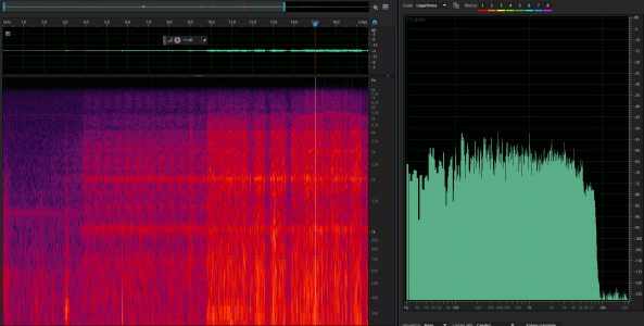

Hello everyone,
today I tried to connect my Crack (with Speedball) directly to the ObjectiveDAC output (which is USB powered), excluding the Objective2 Amp from the chain.
The setup is  PC --(USB cable)--> ODAC ---(RCA cables)---> Crack. In this situations it gets very noisy event at low volumes.
If I connect the ODAC to the laptop the noise goes away even if the laptop is powered only with the power adapter (battery pulled out).
I read something online about ground loop, but my noise is not a constant 50Hz buzz, it has higher frequencies components (I made a recording to let you hear, but I cannot post external links or upload audio files here) and gets worse when the CPU use is intense.
Do you have any (cheap) idea on how to solve?
