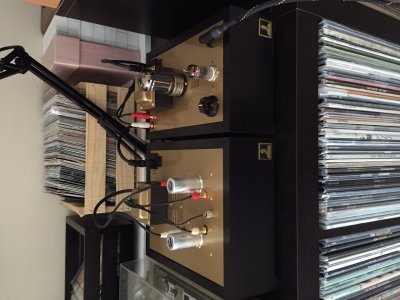

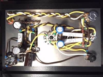

Here are some pictures of my build

Nice nice, I really like the color of the top plate. I screwed up on my spray paint on my top plate. I pretty much have to de solder everything to fix up the ugly paint job ughh!!
