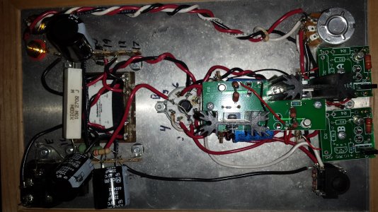

Yesterday it was working great. Using it today however, only the left channel is is working but is quiet and at louder levels become distorted. On the speedball upgrade the LEDs located on the big board near the top do not light up and the top most led on attached to the small tube does not light up. I checked the voltages and at a glance they seemed to be a fraction of what they should be. Also, the top most resistor that spans across the big power block (forgot it's name) becomes extremely hot which I do not remember if this is normal or not. I can provide pictures if needed, thank you.

You should go back and do your resistance measurements again. You might also want to post pictures of the underside.

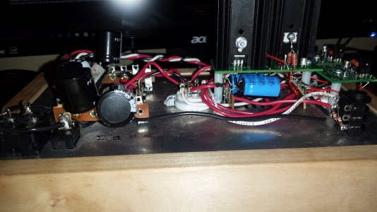

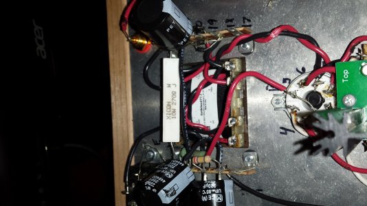

Having troubles with pictures
Offline jmineart
    • Posts: 18
Reply #7 on: September 02, 2015, 01:17:56 PM
only letting me post one at a time
Offline jmineart
    • Posts: 18
Reply #8 on: September 02, 2015, 01:19:07 PM
More

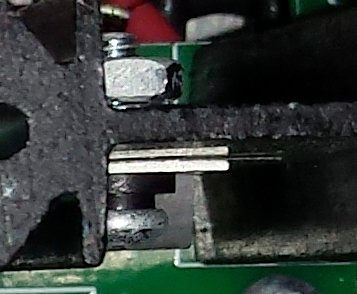

This suggests an improperly mounted TIP50 transistor (check the directions in the manual, specifically regarding the fiber shoulder washer and transistor insulator).

I can get you close up pictures on how they are secured but I can not for the life of me tell the difference from the manual. However, screwing and unscrewing results in a reading of overload before the unit is turned on. Then all of the lights turn on when the amp is powered on, however they soon go out and when I check the resistance after it is back to zero.  Actually it seems like after some time it goes back to having the overload charge.

What do you know. I loosened the screw just a tad on the uppermost TIP50 transitor and now it works like a charm. All of the voltages check out. Weird that this problem sprung out of the blew. Thank you very much for your help!

The heat sink at the front is clearly mounted incorrectly. There are two "bumps" visible below the screw head, and there should only be one. The shoulder washer must have its ridge seated in the hole of the TIP-50—this isolates the screw (and therefore the heatsink) from the transistor. Most likely the second bump is the lock washer that should be on the other side of the sink.

Good catch! That seems to have it working again. I will give it a day again to see if it stays working but thank you very much in the mean time!
