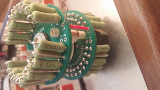

I'm having trouble figuring out the ideal way to hook up my Elma 24 step attenuator.  Bought from someone for a very good price as a gift of sorts, it came with a small piece If wire connecting the L and R channel wafers, which changes the wiring scheme compared to the stock pot.
Does anyone have any suggestions?
Need to double check with my ohmmeter, but A is input and B is output.
Any help, or creative ideas would be greatly appreciated.

Forgot to add this is a 50k attenuator, Not that it should effect anything.
When it is all the way down pads A and C read zero, c is ground, and B reads 50k
Turned all the way up, pads A and B zero out, and A and C, and B and C both measure 50k.
Thanks for all the help.  I have an Alps Blue Velvet along With the stock pot if worse comes to worse
Edit: also when turned all the way up if I measure A (or B) on the top deck and A (or B) on the bottom deck it equals out to 100k, but I assume that's the combined resistance of both decks.

If "C" is ground, then wire the black wires from the STP wires to the "C" pads.  You'll need to pick one level to be left, and one level to be right.  It doesn't matter which you pick, just be consistent.
"B" takes the red wire coming from the RCA jacks.
"A" takes the red wire going towards to the tube socket.

Thanks so much CB!  That is what I thought, but I needed confirmation.  Have a great week!
