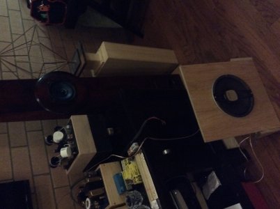

Bigger than a breadbox, smaller than a refrigerator, (just barely  ;) )  2 x 12" Alnico cone drivers in the bass bin.  Mid & Tweeter horns are Alnico compression drivers.  These were released in the '60's to compete with the Altec Lansing Voice of the Theater speakers.  About 102dB/1W/1M.
They came stock in "gig attire", any color you want as long as it is black.  This pair was originally the studio monitors for Ampex Records, a short lived part of the Ampex Corporation.  (Or so I was told by the guy from whom I bought them.  He said he was a tech at Ampex and got the speakers for his band.)  Since he lives near the old Ampex campus, likely some truth to the story.
I sheathed the bass bin cabinet walls with Baltic Birch play to make them about 1" thick. Really tightened up the bass definition and timbre.  The crossovers were redone and the mid horn refinished.  I really enjoy the sound.  Not much bass below 50Hz or treble above 16K Hz.

Awesome setup, Geary.  Have been using 4 pair or 9 pair arrays of Thrashers with custom wiring harnesses to get mega efficiency like that :)
