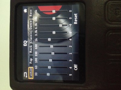

I have my HD800s with the Mainline as amp and Ibasso DX90 line source.
I have as many others been struggling with glare in higher frequencies e.g. Cymbals and such.
I am on the waiting list for the Anax 3.0 mod
This article is interesting and Ive tried setting the EQ in my player according to the graph in the article. http://www.innerfidelity.com/content/big-sound-2015-bob-katz-eqing-headphones-harman-target-response#KcKd2q2cZTqoEDq0.97
The glare is more or less gone and it is definitely more listenable.
Any thoughts on EQing and this in particular?
The attached photo is from my DX90 EQ
