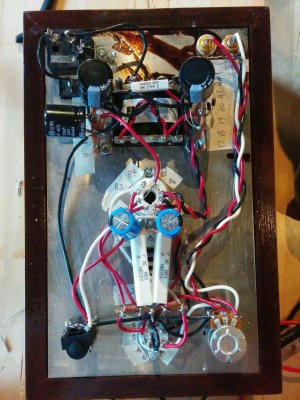

Hey, I'm having a bit of a problem with my Crack build and I can't quite diagnose the issue. After first finishing my build all resistances checked out correctly however the rectifier between 19 and 21 was installed in reverse causing a blown fuse. I corrected the issue and everything seemed to be working correctly. Tubes successfully lit, LED's were on etc... however, I failed on a voltage check (I've now forgotten which connections failed).
I attempted to touch up a couple of solder points however my resistances have all gone to hell now and I just can't figure out why or how. Here are my current measurements:

I've re-checked my build again and can't find any problems/faulty solder points and would REALLY appreciate your help/feedback.

If you don't have 0 ohms at terminal 3, your amplifier was never safe to turn on...
Which terminal are you using for ground?  Whatever terminal it is, it appears to not be grounded.

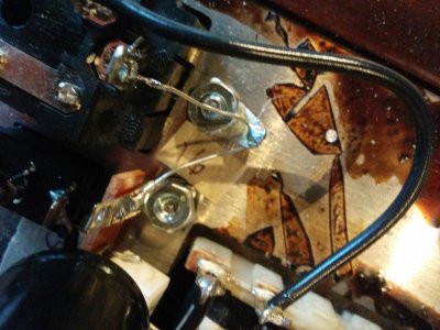

Also, there appears to be an "extra" wire around/under terminals 12 and 13.

The extra wire you're seeing under 12/13 is actually the power switch to power transformer 1 connection (page 17 in the manual).
I've been using terminal terminal 12 as ground as suggested in the manual (sorry I should have stated such in the beginning). I originally had to spec resistances including 0 ohms at terminal three before resoldering a couple of connections which is partly why I'm is so confused at the moment. For what it's worth the resistance reading at terminal 3 is not stable - it jumps erratically and in fact is now settling at 38 M ohms
Visual inspections don't reveal any incidentally overlapping connections or touch points on the chasis body itself nor does there appear to be any insulation missing from any wires.

I've been using terminal terminal 12 as ground as suggested in the manual [...] For what it's worth the resistance reading at terminal 3 is not stable - it jumps erratically and in fact is now settling at 38 M ohms
These terminals connect through the ground buss of black wires.  Since you don't have 0 ohms between these terminals, there is a failed connection or a missing wire. The amplifier must not be turned on until this is corrected.  The most common issue here is the junction of the black wires on the headphone jack not being appropriately soldered.
