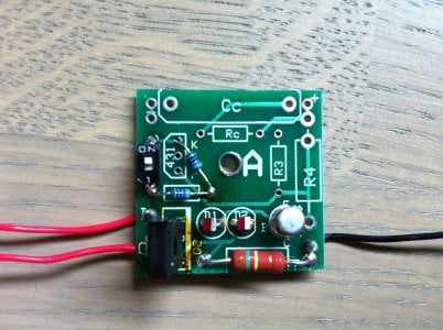

This is my rendition, single 470 Ohm for E80CC and two 470 Ohms in parallell (making for 235Ohms) for running 12AU7.

Well, my mod is straightforward.
All You do is remove the 235 Ohms. R1 resistor from each small PCB, replace with 470Ohm, add DIP Switch and additional 470Ohm, as shown,  they are connected via a thread on the rear side that is already in place, afterwards check resistance across either of the newly added resistors for 470 Ohms when switch is in Off, and 235 Ohms when in On, and You're done.
