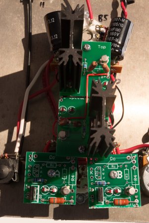

I have been enjoying my Crack since Feb 2014 and finally found some quiet time today to do the speedball upgrade.
Build went smoothly, however when checking voltages, I had all correct readings excepts for 7 and B3 reading 55V instead of 100V.

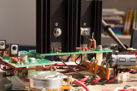

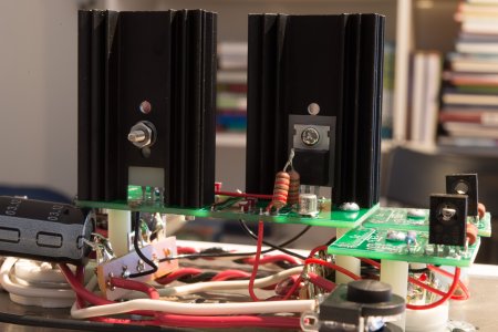

I am attaching three pictures below if this helps.
I am missing my crack already  :-[, if you can help that would be very appreciated.

If your voltages at 1-5 are indeed correct, but you have 50V at terminal 7, then I would reheat all the solder joints on the large PC board, focusing especially on the center leg of the TIP50C.

When comparing again my build with the manual I noticed that the gap between the board and the 2N2222A transistor is larger on the picture than on my build (see picture in 1st post). May this be an issue?
