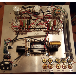

I just recently completed this build and, oh man, is something not right. With the volume all the way down, there is a loud hum, a bit of buzz, and crazy microphonics -- to the point that it starts to feedback through the speakers and get louder and louder. Also when I turn the volume knob, there is a loud scratchy sound. But when playing music, things generally sound ok (despite the noise in the background), however, even when the volume knob is totally maxed out the listening volume never gets above moderate levels.
I've already looked over all of the wiring and everything visually looks ok, but I'm going to go back and re-solder anything that looks even mildly suspicious. All of the measurements checked out fine, though most of the terminals marked with an asterisk gave a resistance of "1" on my ohmmeter (but not a zero reading) with no fluctuations. All of the voltage readings were within spec, though the readings at terminals 4, 9, 20 were a bit high (160 vdc rather than 150). Is there anything else I should be looking for while re-soldering?
I've read elsewhere that hum/microphonics can be an issue with high gain and high sensitivity speakers. My speakers are DIY, about 98 db sensitivity, and I'm running though the power amplifier stage of an old integrated Onkyo A10 amp, at 85 watts at 8 ohms, 50 kohms input impedance. Any thoughts?

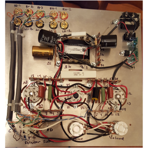

Offline Rublyow
    • Posts: 40
Alright, went back again, rechecked all of the wirings step-by-step, and touched all of the joints up again. I rechecked the voltages, and I made a mistake reporting the previous voltages -- the 3.68 vdc is actually on the A7  and C7 terminals. The A4, C4, A8, C8 all read about 1.6. When I turn up the precision on the ohmmeter, terminals A6 and C6 read -0.22 and -0.1 rather than exactly zero, but that was the largest deviation I could find from the specified voltages. The full readings are below.
I just fired it up again, and no change at all to the hum. One thing I noticed, with no source plugged in, the hum is loudest when the volume is all the way down, and drops to almost bearable levels when the volume pot is at about 50% volume, then rises again when the volume pot is at 100%. Not sure if this helps diagnose the issue at all.
Also, I double and triple checked the 220uf/250V capacitors and they are definitely stuck on solid.
So how else can I trouble shoot this problem? Is there any way to verify it's not an issue with one of the tube, or is there any other way to diagnose where/if there is a flaky ground connection other than continually re-solding the joints?
Not that I image it's terribly helpful, but I've also attached a couple of images in case there are any glaring errors that I keep missing.

Offline fullheadofnothing
    • Posts: 1487
The fact that the hum level is affected by the volume control suggests that it is being picked up by the input wiring. Since you're not shorting the inputs, it's not as conclusive, but it's pointing in a direction.
Is it the same on all inputs?
Have you tried it in another room with different equipment?

Offline Rublyow
    • Posts: 40
Yeah, the hum is the same on all inputs, regardless of if I have anything plugged into them or not. I unfortunately don't have another setup to try. I did plug in my Quickie just for comparison and that is pretty much dead quiet. And for a point of reference on what the hum sounds like, if I touch a tube on the Quickie while on (or even put my hand really close to a tube) it causes basically the identical hum I get out of the Smash. I did try some -12 db attenuators and that definitely made the hum quieter, but didn't really fix the issue.
Is it worth just rewiring the inputs and the volume/balance/selector switch, or is there a better way to trouble shoot the issue?
