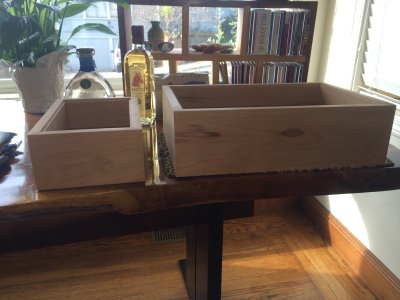

Reply #5 on: January 25, 2016, 10:51:36 AM
Started my base and a matching one for my Crack.  Can't wait to get this amp started! I went 5" deep to accomodate a few custom mods and caps.
BTW, I find a good bottle of tequila really enhances my soundstage and holographic imaging, A lot more air too.  Cheaper than caps but the problem is it is only temporary  ;D
