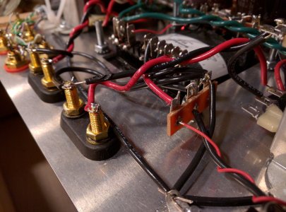

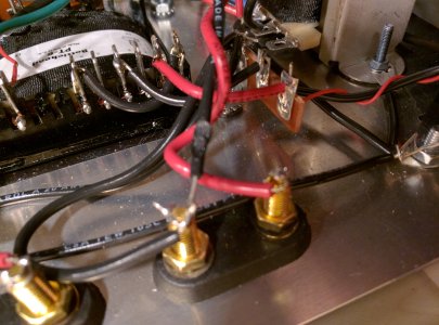

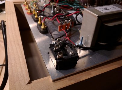

Post a photo of your black and red power supply jumpers that attach from the terminal strip to the set of 6 lugs.
Offline Stalemate
    • Posts: 31
Reply #12 on: February 03, 2016, 10:02:38 AM
Hi,
Here you go
v
Offline Deluk
    • Posts: 441
Reply #13 on: February 03, 2016, 11:42:14 AM
Shouldn't the black wires be soldered to the earth tag at the bottom of the first picture?
