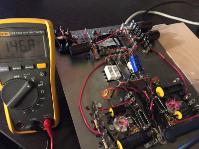

So I just built a Reduction, and I have a couple questions.
1.  I am showing 150V on terminal 2, where the manual says it should be 70V to 90V.
2.  The red LED from the center post of socket A to post A3 does not light up, where the same LED on socket B does.
Any thoughts on what I screwed up?

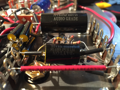

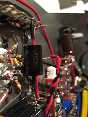

EDIT:  I noticed one difference between the pic in the manual and mine:  the manual shows the capacitor between terminal 6 and 14 at 0.1uF.  The part I received is 0.01uF.  The one on the other side is the proper 0.1uF.
Would that account for the voltage change and LED not being active?
(I've attached photos of the two different capacitors)

    • Posts: 20297
Reply #1 on: February 10, 2016, 02:05:41 PM
That's certainly a misprint on the label of the cap, we'll have to check our inventory to see if there are any more like that.
One thing to try is to swap tubes to see if the voltage issue follows a tube or is related to the actual build.
Your voltage indicates that one of the triodes is not drawing current.  If this problem does not follow a particular tube, let us know and we can direct you on debugging.
