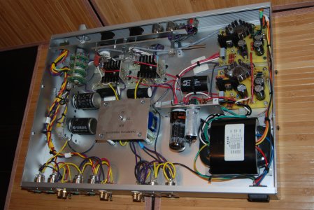

Yep I was scratching my head about those extra tubes and curious enough to save a pic for reference.

It is a 6C45 based headphone amp, but not really a Mainline. Too many differences (I would not call them improvements) to call it that.

I actually built this some years ago.  It roughly splits the time difference between Doc B's big headphone amp with the wood front and the current Mainline offered today.

I'm also really curious about that tube in the shield, is it a rectifier tube?

Yes, I was experimenting with small form factors, which necessitated the use of a power transformer with a little more voltage than I wanted.  One way to shed some of that extra voltage was with a rectifier tube.  (Hence some of Doc B's comments)  I have absolutely no recollection of why I put a tube shield around a rectifier tube, but it may have been in part to keep it in the socket while transporting the amplifier.
