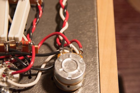

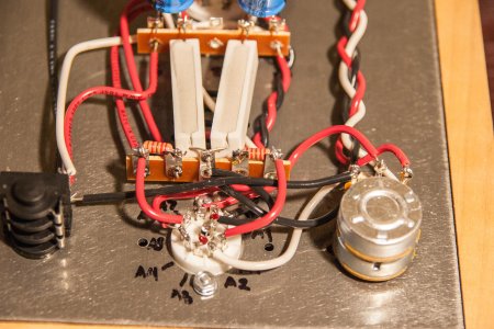

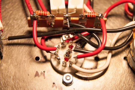

Chopstick tested again, with the A7/pot wire being extremely sensitive to even a wooden chopstick being placed near it. Completely replaced and re-flowed the wire, with no changes. Re-snugged all grounding points as I could hear a change in tone when I pressed my finger against the base plate. When testing the A7 wire, I also noticed the further I moved the wire from the terminal strip and wires coming into A9 & A4/5. Photos attached of the socket and surrounding wires.Completely miffed at this point, and definitely frustrating as I was finally enjoying it. Thanks again so much Doc for taking the time to help with this one.

The end of the red wire at A7 looks good. Where it is attached at the other end to the center pin of the pot looks it might a little light on solder in the photo. Or it could just be the angle of the shot. You might also tuck that red wire over a little closer to the pot and farther away from the red and black twisted pair that feeds A4 and A5.
I would also be inclined to reflow the lower center terminal of the front T strip, T3L, since that is a point of contact between signal ground and chassis ground. From the angle shown there is no solder filling the hole.
