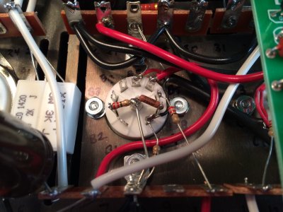

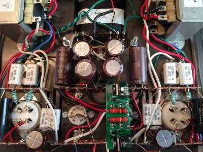

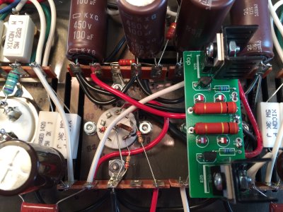

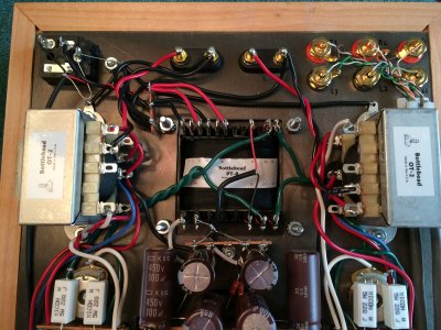

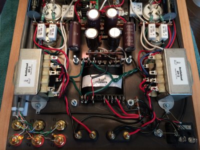

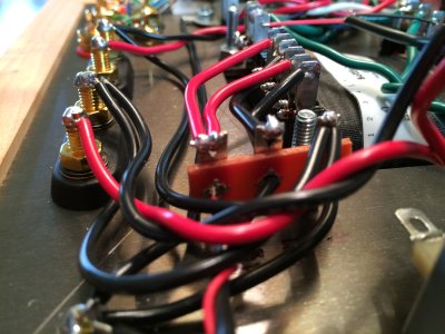

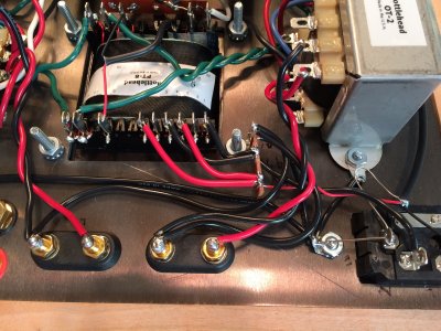

Perhaps some pics will aid in the investigation.

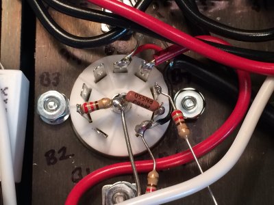

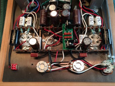

Reply #2 on: February 28, 2016, 03:54:12 PM
A few more.

There's one more step, to disconnect the black wires going to the plate chokes next. If the fuse still blows after that, the 2A3 and 12AT7 circuits are pretty much ruled out as the cause and the problem will most likely be somewhere in the power supply. I apologize that I haven't had the chance to look at the photos you posted yet, but I will try to give them a look this evening.

I don't think this is necessarily the problem since the fuse only blows with the switch on, but I notice that the foil on the shielded twisted pair cable coming from the power switch back to the power entry connector looks very close to the metal of the live connection on the connector, at least from the angle in your photo. Might want to make sure it isn't touching. Also just to cover all the bases, what size fuse have you been testing with?

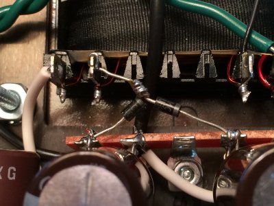

Next I will suggest inspecting the rectifiers. Amp should be unplugged. Does your meter have a diode test setting? The setting will have a little triangle and straight line symbol if it does. If not, just set the meter to the K ohms range.
Touch the black test lead to one end of one of the UF4007 rectifier diodes at power trans terminal 19 and the red lead to the other end of that same diode. You should see either an OL reading or something roughly around 1.5K ohms. Swap the leads the other way around and check again. If the numbers aren't exactly those it's OK. If you see a very low reading like under 100 ohms, that diode is bad. Check both diodes the same way.
I will also suggest carefully rechecking the connections all of the resistors that are connected under the filter capacitors. A miswire anywhere in there could definitely cause a blown fuse.

Rectifiers checked on diode setting:
0.L - .519 V
0.L - .522 V
