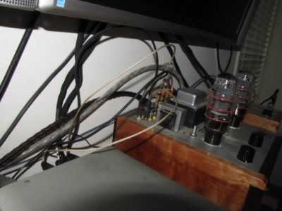

Stereomour uses single ended 1/4 jack interconnects.  I use plain copper wire with cotton insulation, no wrap or twist, just separate the wires. Very inexpensive and I have compared the results to many much more expensive interconnects and prefer these to most of them.  Just buy some decent male connectors and get the wire and cotton insulation separately, measure, solder and you are good to go. IMHO, all that shielding and twisting is ineffective and just complicates things.
wire is 22 gauge, I have tried finer guages (26, 28) but like the 22 best for sound, it is also nice and stiff and so can be arranged with plenty of separation between wires.

As you well know there are trade offs to every configuration. I have found that in my setup. Using the shortest possible interconnects with separate wire sounds better than any of the other solutions I have tried.  Of course. I listen near field at not very loud volumes and every system is different. As the OP will soon find out there are as many opinions on interconnects as there are, well you know  8)
The great thing about diy is you can try a lot of different wires and configurations without spending a fortune and see what works best with your ears and system
