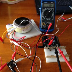

Offline JamieMcC
    • Posts: 1171
Reply #6 on: March 20, 2016, 07:14:42 AM
hmmmm....  I wonder what small power amp requires 2x 19v power supplies....hmmmm
I'll bet I know!!  Sounds like a cool idea.  Don't forget to share!
I'm still waiting for some parts but have made a start on ACA psu (still waiting for the transformer for the Quickie side to arrive. Its been a pretty educational project so far.
So a teaser pic of progress from this morning.
One channels psu in prototype form (my first ever mock up)! Pretty pleased that it works and the voltages look ok (running without load) this should give me the flexibility to experiment with running slightly higher voltages and bias settings as some do. I need to install a permanent bleed resistor next to discharge the capacitors rather than using one on fly leads.
