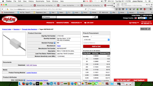

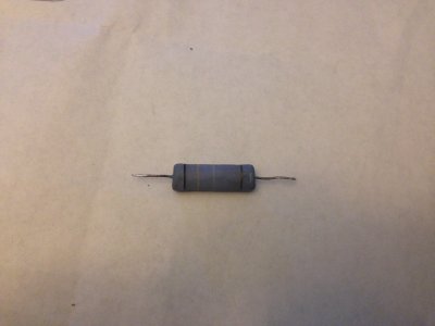

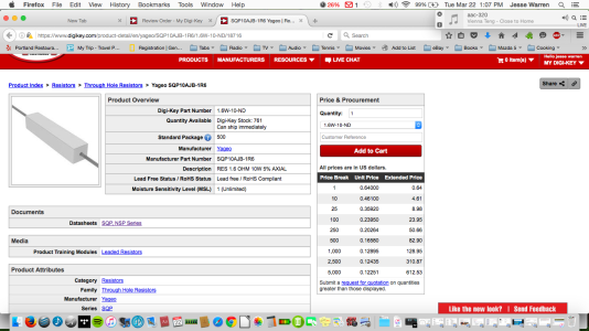

Are these acceptable?
    • Posts: 20294
Reply #9 on: March 26, 2016, 06:48:05 AM
Those are 1.6 Ohm and 4.7 Ohm.  You want 1.6K and 4.7K, which are 1600 Ohms and 4700 Ohms respectively.
