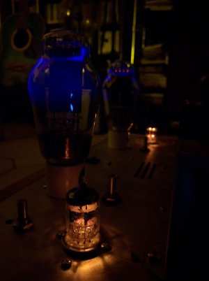

Just sharing this picture that I took last night after listening to the frankly amazing new King Crimson live album. And yes, I have done lots of reading about "the blue glow". Hopefully all is well... it started a few hours after initial use. Everything sounds wonderful.
Paul.

After a couple of weeks my Eml's still have a slight blue glow and it sounds better and better.  I don't think there is any problem
Coincidently I was listening to king crimson's Zoom. Last night. Would love t find a Hi res digital version of "in the court"

Just reporting back... I received the DC filament upgrade kit today after it spent a brief spell trapped in customs. It was a very easy hours work, the amp works fine, and is now absolutely silent. Interrestingly the blue glow I reported earlier in the 300Bs has now gone completely. Anecdotally tbe bass seems a lot better, but the CD I;m listening to right now is bass heavy so it might be coincidence.

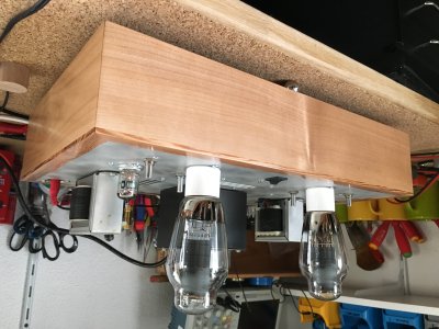

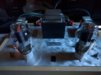

So in the end I got there as well - at least it looks like at the moment... :P
yippie - I just finished my first Kaiju with stock parts - have a second kit just waiting to get assembled - but for this one I will use some other caps and way more silver wiring - everything I need just arrived two days ago... Curious about the difference
After adjusting hum balance I get 7 mV on the left and 5 mV on the right channel - seems more or less okay.
I did not yet install the DC filament upgrade - looking forward to that...;o) But first I'll let it run a while and listen to some music...
I just put it in its chassis...;o) looks nice.
I am using EH 300bs, I had around anyway - got the EH 300b gold and a matched pair of PSVane mesh plate 300b N (as far as I know they do meet the standard 300b specs as well, maybe I'll try these later on beside someone tells me not to.
So far no smoke or strange sound so I go on listening...
so long and thanx for advising the crazy newbie from switzerland.
Cheers and a great weekend to everybody
Chris
