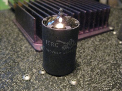

Does anybody know the part number for the IERC tube shields that fit the Mainline 6C45pi tubes?

There are many different types of IERC shields that will fit, the open versions require a base which is very hard to find, but most are simple slip on.  The ones i used are TSN6-6015b but they are very rare, look for any with a 6015 in the part number, usually listed for the WE417a and 5670 tubes.
