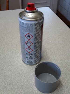

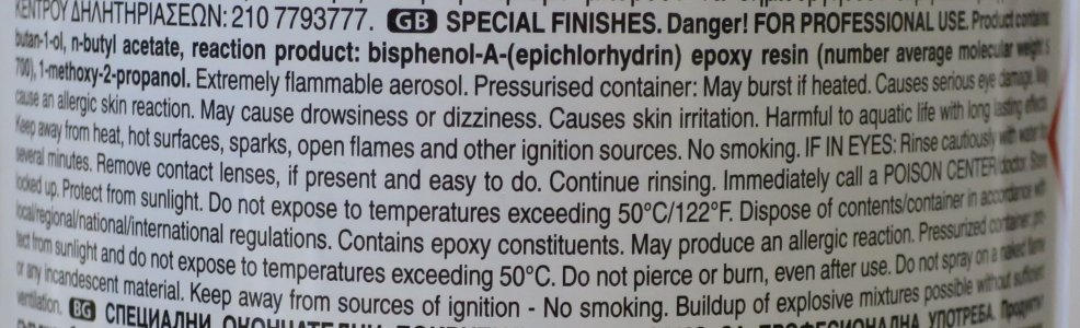

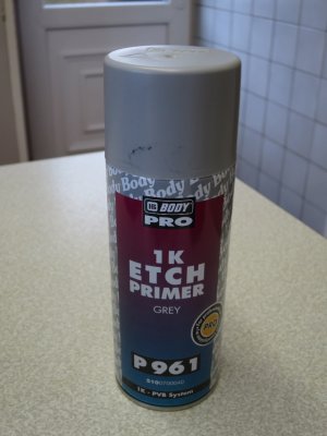

Here we have pictures of the other can I bought at the same time. It says quite clearly that you shouldn't even store above 50 degrees C. My limit of high temperature touch is about 55, so the fact that I needed to wrap the can in kitchen paper suggests 70-80 degrees (apologies to those defaulting to think in Farenhiet). It says "may explode if heated" so it did exactly what it said on the can.  :-[
