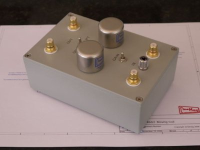

Here's an SUT I built using the Cinemag 3440AH done Bottlehead style, to give you an idea. A switch for the two gain ratios & ground lift switch in a simple Hammond aluminium case (these come painted so saves some work). This unit works perfectly with no noise.
Fixed leads are ok, but as Josh mentions you would put them on the output & have RCA input jacks.
The ground terminal can be called a binding post, ground post, earth post, etc
Not heard the CM-1254, but the 3440 at one third the cost performs very well.

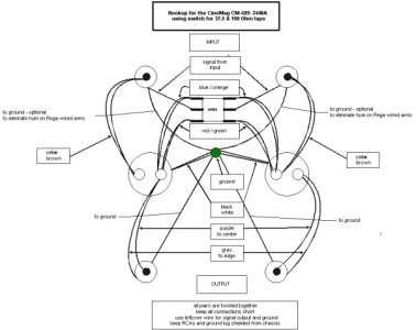

Anyway, DPDT switches have 6 terminals, two centre common used for L&R signal in, then one side is connected to the 37.5Ω taps of each transformer, other side connects to the 150Ω taps of each transformer.
This diagram from the web maybe shows it better.

Thanks for that diagram!  I see what you are saying about the dpdt switch now.  But to me, the diagram you posted is different from the Cinemag diagram ( http://cinemag.biz/phono/PDF/CMQEE-3440A-Moving-Coil.pdf ).  For instance, in the Cinemag diagram, the red and green wires for the 37.5.ohm tap are on separate terminals, shorted only when the switch is in that position, but in the other diagram, they are always shorted on the same terminal.  From the Cinemag diagram, I assumed that each channel would require its own dpdt switch.  Your way is more efficient.

Yes, I see what you mean. It is a slight variation or an interpretation of the Cinemag schematic. As you say, it is a more efficient way of achieving the same result. A web search will show many DIY Cinemag SUT's wired like this with a single switch for the gain.
Would like to say it was mine, but I just found it on the web.
