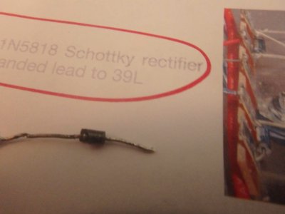

I did - and in doing so I found where the smoke came from ( see attached pics)
I found nothing else - but here is a question. I think that 1N5818 was part of the heating circuit ...since I can find nothing else wrong - would be a feasible explanation that powering up WITHOUT the tubes in would overheat this component?
I have ordered new ones online - I plan to replace it and try again ... I will let you know what happens ;)

If you power up your Reduction without any tubes installed, almost all of your voltages will be wrong.
