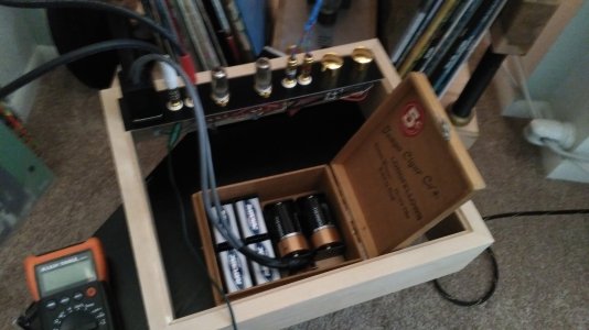

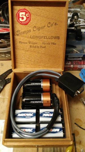

I know we are admonished to build 'em stock first to help with any issues, but since my Stereomour II build I have been hooked on the simple balance circuit. So...I ordered a custom 1.75"x12" black anodized panel from FPE (no affiliation),drew a wiring plan and heated up the iron. Using an old cigar box for the batteries and 2 lengths of shielded 4 conductor, stranded wire into a 9 pin connector for power all the resistances and voltages checked out. I temporally inserted it between my Reduction and Stereomour and ...it's alive!
I will let it burn a bit before any critical listening, but there is no added hum or noise.
If my math is correct, the stock alder Stereomour II case it is sitting in has just enough room for a Seductor and a 1/4" strip between the panels. (How's that kit coming along Josh?)

One thing I did notice was there wasn't any added gain. (I was able to A/B it because my Reduction has 2 sets of switchable outputs, just flip the on/off/on toggles and change input on the Stereomuor) In fact, I think the system played a little louder without it, and I noticed that the Quickie volume pot was almost wide open.
To be fair, the "direct" route is through 12" PBJ cables while with the Quickie there was a 1m pair of Blue Jeans in and a 0.5m pair of PBJs out.
I was just happy I had volume and balance control and the BH sound after fooling around with everybody's favorite $99 kit!
