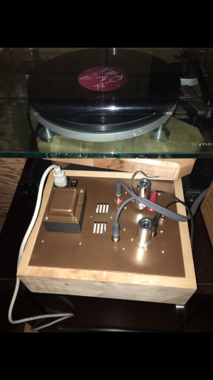

Just built the reduction. Honestly its unbelievable. Why havent i been spinning records??
Sounds better than the bh dac running amarra tidal. The only thing is the output is low. So i have left it on for a few days now to try to burn in The tubes. Im using a michell tecnodec with grado prestige cartridge. Im also going to add the integration soon too.

Yup, putting in the Integration upgrade will give you about 3-4dB higher output.

Ya the volume is perfect now! And it all sounds sooooo good! Amazing kit!

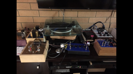

Put the reduction to a hot rodded quickie (instead of the efp3).  Really quiet background now. Really really good sound. So effortless. Great job team bottlehead!!!
