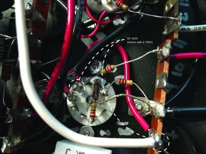

I just recently completed the Stereomour II kit, went through all the voltage checks and resistance checks and everything worked great...for about a day. Then, when I fired it up on day 2 - the left channel gave a weird buzzing-whooping-humming sound that was not constant, and did not output hardly any volume at all (I could still - barely - hear the music). I unplugged the speakers, flipped the kit over, checked a few things, re-soldered more joints than I care to admit, but I am still left with one anomaly - when I do the voltage check, I get a voltage of something like 99-105 DVC out of terminal 7, instead of the normal 170-230 VDC to be expected. For comparison, I get something like 180-190 VDC out of terminal 14, which is the mirrored terminal and is of normal range. All the resistance checks are more or less normal.

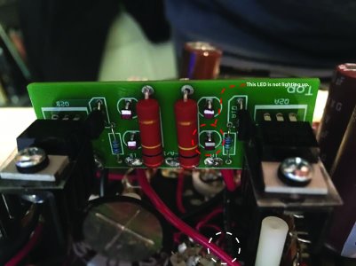

Also, I just noticed that the LED nearest IA (the top left LED looking from the top) is not lighting up, which I suspect probably has something to do with my problem as well.

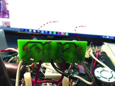

Ok, I did a bit more reflowing of joints, examining what I have and making sure it's all hooked up correctly. I also swapped the tubes once again to see if that was the problem, but other than slight variations in the tube voltage the problem remains the same - Terminal 7 is approximately 50% of the voltage of terminal 14 (about 100V vs. about 200V), and one of the LED's on the board is not lighting up. I tried to take measurements of as many different connections as I could, and the anomalies I found are attached.
I think it has to be in the tube / board somewhere, but I cannot figure out where. At this point I've reflowed all the joints but it would appear that I am still losing about half my voltage to somewhere on my right channel.

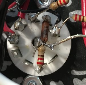

I just noticed another thing looking at the high-res photo of the tube connections - it looks like I may have cracked the 3650F metal film resistor that runs between the center plug and pin 8 on the pin socket, and indeed when I measure voltage between terminal 8 and the corresponding pin plugs on both tube sockets, I get a discrepancy that is similar in proportion to the current discrepancy I have between terminals 7 and 14 (something like .95V vs. 2V). Could I have potentially damaged this film resistor? If so, where do I go for such parts now that Radioshack is closed?
    • Posts: 5908
Reply #7 on: May 21, 2016, 08:40:46 AM
You can measure the resistance of that 365-ohm resistor to be sure, but definitely replace it - even if it's the right resistance, the protective coating is broken and it will corrode. Email [email protected], and Eileen will get it in the mail probably on Monday.

You have a backwards transistor on your driver PC board.

Reply #10 on: May 21, 2016, 01:23:10 PM
Well...I feel quite stupid.
I flipped the transistor around boom, works like a charm.
