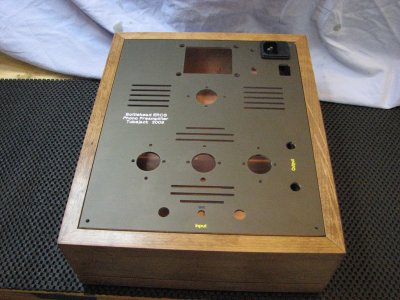

I'm also building the amp on a 10" x 12" chassis and I'll be adding some extra ventilation slots as well. A friend of mine is going to lay all this out in a CAD system with me telling him where things will go in the larger format, then we'll just take the drawing file and plate over to the local water-jet place to get the plate cut. I was going to try to mill the whole thing on my drill press with a cross slide table, but decided against that. :-).

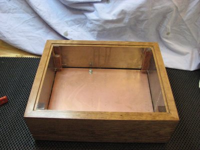

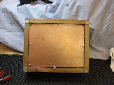

Offline Tubejack
    • Posts: 113
Reply #5 on: May 27, 2016, 01:28:44 PM
It was probably overkill, but on my EROS build I did line the inside of the base with copper foil and installed a bottom made from double sided Cu PCB, all(http://) tied to the chassis ground.
Never had a ventilation issue .....
