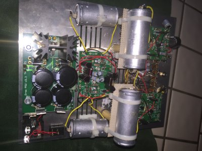

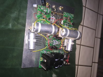

Mika,
The .1uf caps while big fit perfectly next to the circuit boards.  I used a plastic tie and a self adhesive tie down tab right next to the circuit board.  This helped isolate this cap from the metal top.
The .22 uf caps are very big but again they fit perfect in the spot right above where the .47uf caps were located.  I used a plastic breadboard circuit board and tied the caps to each one with a plastic tie down.  I then cut a couple of wooden dowls to the right length and placed them in the position above where the .47 caps were attached.
I attached a couple of pictures that might help.
Richard
Looks great, thanks!  I'm waiting for all my parts to arrive before I start modifying.  I can't wait!
