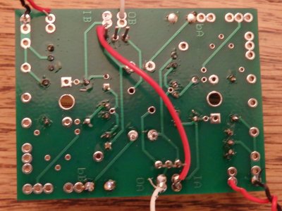

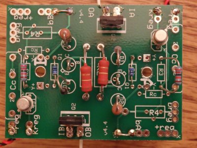

After reading some of the posts regarding a mismatch of photos and instructions for the PJCCS, I am concerned that my build (Quickie Manual V1.1) followed the instructions that I have but is incorrect.  Is it ever permissible to have a successful builder take a photo of the functioning completed circuit board and send to me?  A macro close-up would show me the details and I could compare it to mine and see if I am correct.  For the purposes of patent and security it could be a private message.  Is this possible and proper?  Thanks.
Offline fullheadofnothing
    • Posts: 1487
Reply #5 on: May 31, 2016, 04:44:16 AM
Post pictures of your build. The manual has macro photographs of a working board at 300 dpi. Zoom in to see whatever details you think you are missing. The discrepancies between manual revisions you refer to will not cause a board to only function on one side(and the six year old issue cpaul referred to is wholly irrelevant). Build errors and bad solder joints cause that kind of issue. Most common would be a weak joint on the middle leg of the MJE-350.

Reply #7 on: May 31, 2016, 06:20:06 AM
The solder joints on the MJE350s are bad. They need to be redone, with a little more solder added.

Reply #8 on: May 31, 2016, 06:30:55 AM
Thanks!  I'll get to that hopefully sometime today. I skimped on the solder since the board is so small. I'm learning.
