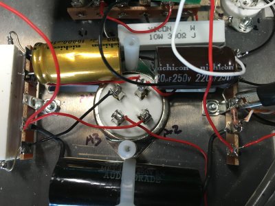

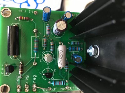

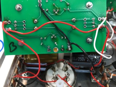

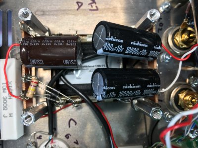

Can you post photos of the offending side of your build, including the tops and bottoms of the power supply board, as well as the wiring under the C4S board?

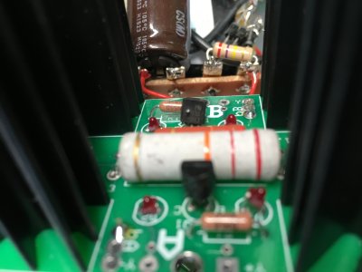

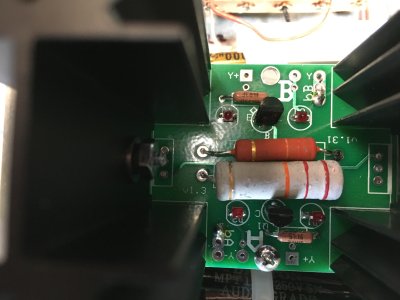

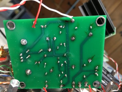

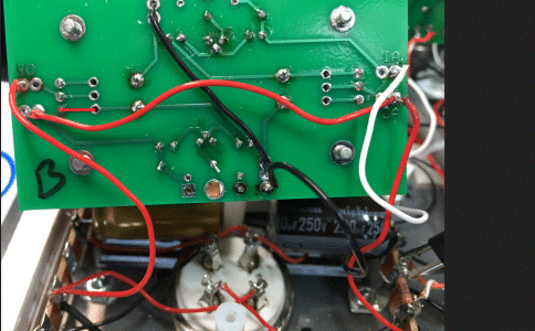

Here are some photos of the bad channel. The C4S board was working in the other channel, but I messed up on the switch and it gave a puff of smoke. I see a dimple in the B side 2N2907 so I wonder if its bad too. I only replaced the A side since it was clearly damaged.
The PSU board looks identical to the working side, but the resistances don't match, so I'm convinced something odd is going on there. I've noticed that when I measure the resistance at 6 to ground it starts off high (0L), goes down to below 8 KOhm and it eventually settles at 19 KOhm. The good side settles right at 140KOhm.
James
« Last Edit: June 06, 2016, 08:18:44 AM by jjvornov »
    • Posts: 20290
Reply #11 on: June 06, 2016, 09:07:09 AM
On the "B" side of the C4S board bottom surface, where the MJE5731A mounts, it looks like some of the copper trace is gone, which would cause some issues.  (BTW - the 300B not drawing any current will throw off your Kreg voltages up on the power supply PCB)
You can restore this connection by using a bare piece of wire to attach your current solder joint to the empty pad on the same trace.  I've made a little picture to assist you.
    • Posts: 9782
Reply #12 on: June 06, 2016, 09:11:03 AM
Blowing that image up, it looks also like there might be a lot of flux and not enough solder on the pin associated with that trace.
Offline jjvornov
    • Posts: 93
Reply #13 on: June 06, 2016, 09:36:12 AM
Tried resoldering and the jumper- no change in the voltages. Actually, it checked out by continuity testing with the multimeter as well. It's something I've become habitual about- checking continuity across the build as I go along.
