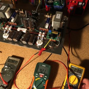

If I measure IA on both sides I get 421 V @ 235 V AC input - much to low - before all measurements went fine. Nevertheless I get the needed 300 (298) V on OA.
Adjusting the voltages @ 32U and 46U with the trim pots - I get 175 Volts on the A Side board. On the B side as well in the beginning - then I thought let it sit for a while and measure again and after maybe 20 minutes I get 186 V on the B Side board at the end of the trim pots way and the voltage seems to even climb higher - that's where I pulled the plug - what may this be?
And why are the voltages @ IA to low - before all values in the high voltage tests were within tolerance (521 V @ 14U), all others well within tolerance as well.
critical? What to do / check / resolder / replace?
Thanks for advice.

The 421v measurement might be because the 300B tubes were installed.
The drifting driver plate voltage (175v target) could be a tube issue - swap the 5670 between sides and see if the issue follows the tube.

I had no 300B tubes in place - what else might it be? I will swap the 5670 - and see what happens.
I checked everything about 10 times - no wrong placed parts on cs4 boards or misplaced connections in the rest of the circuit visible so far and the magic smoke remains inside the circuit...:-)
Maybe soldering issue?
I'm soldering for about 5 years now and am using 4% silver solder wire for this kit - for me it works great and as it is so easy to use that I did not want to change habits (even against your recommendations) - normally I even take 6% Audio Note or 10% Silver 1% Gold Mundorf solder wire which works great as well for me (80 Watt Weller solder station - regular use of tip cleaning and tip regenerator recommended) - hope I did not screw up there as it has a higher melting temp of about 227 degrees Celsius.
Looking forward and let you know about results.

Weird things happening here - I only changed the 5670 tubes (using the same ones just changes sides) and reattached my testclips and now I have 505 V @ 230V input on both sides @ IA, 298,6 on both OA and stable 175 V on 23u and 46u after letting it sit for more than two hours - wonder how it looks when I measure again tonite...:-)
Maybe some issues with my probes or soldering or the 5670 not pluged properly or all of it or just magic? Actually I don't get the point - any idea or someone who expierienced the same?
Just one question bothers me right now: should I go ahead or resolder everything?
thanx a lot for advice, regards from lake constance,
Chris

    • Posts: 5908
My best guess about the 5670 is that its cathode was not fully "formed", probably from sitting idle for decades since it was made. I have no guess about the high voltage issue.
If it is working correctly now, there is no way to get evidence about what  is wrong. So I would just use the amp but watch carefully, possibly re-checking the voltages once or twice during the initial 100 hours of operation. I would not leave it on and unattended during that time. If there are no further issues then you can have some confidence in the build and components.
